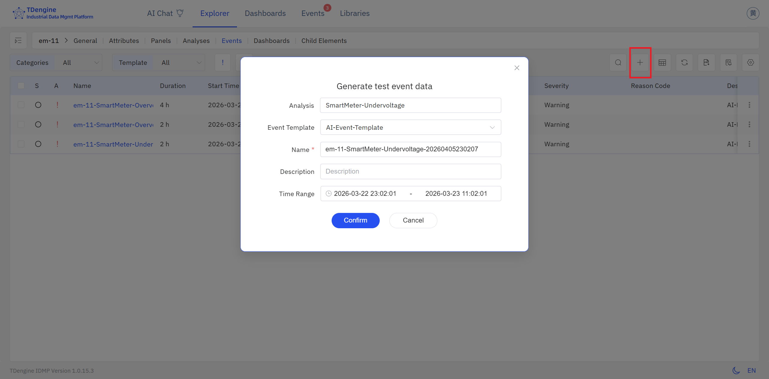

Ad Hoc Events​
Beyond system-generated or manually entered events, IDMP also allows users to create ad hoc events directly — no template or trigger rule required. Users can combine time ranges and attribute conditions on demand to define the events they want to analyze. On the element’s event list page, click + and configure the desired rule set in the Generate Test Event Data dialog.
Ad hoc event generation
Ad hoc events participate in analysis just like formal events and can be overlaid with existing system events in the same chart for comparison. This is particularly useful for:
  • Exploratory analysis: Quickly define time periods of interest before establishing a complete batch management system
  • Supplementary comparison: Precisely target an anomalous period and compare it side-by-side with normal or golden batches
  • Hypothesis validation: Define post-adjustment time periods as ad hoc events and compare with pre-adjustment batches to validate improvements

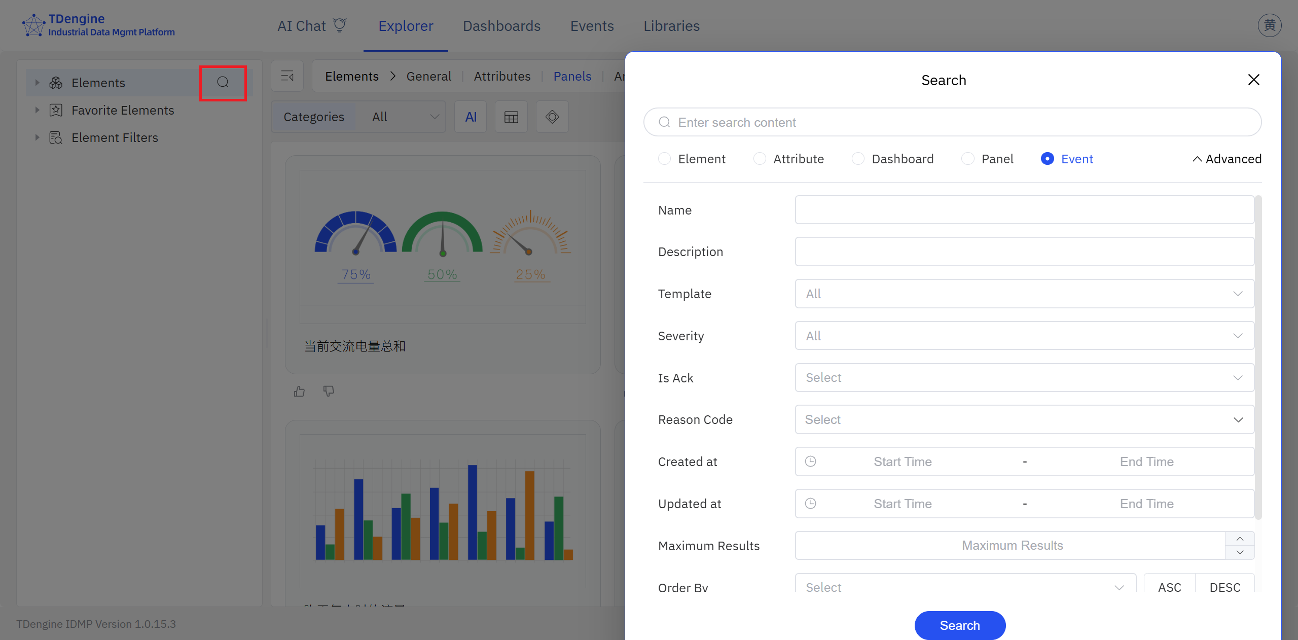

IDMP provides powerful event search and filtering capabilities to help users quickly locate events and add them directly to the Analysis Chart. Batch events, as a special event type, can leverage the full suite of search capabilities.
Search Entry
Click Events in the top navigation bar, or switch to the Events tab on an element details page to enter the event list view. Click the search icon (magnifying glass) to open the search dialog.
Basic Search
Enter keywords in the search box (such as batch ID, product type, operator name, etc.), then press Enter or click Search. The system searches within event names, descriptions, and custom attributes, and returns a list of matching batch events.
Advanced Filtering
Click Advanced to expand additional filter criteria. You can precisely filter batch events by the following dimensions:
  • Time range: Filter by batch start or end time to quickly locate batches within specific time periods
  • Event template: Filter by batch event template to distinguish batches from different product lines or process types
  • Element path: Limit search scope to batches under specific equipment or production lines
  • Custom attributes: Filter by batch custom attributes (such as quality grade, shift, product specification, etc.)
  • Severity: If batch events have severity configured, filter for anomalous or critical batches
Event search

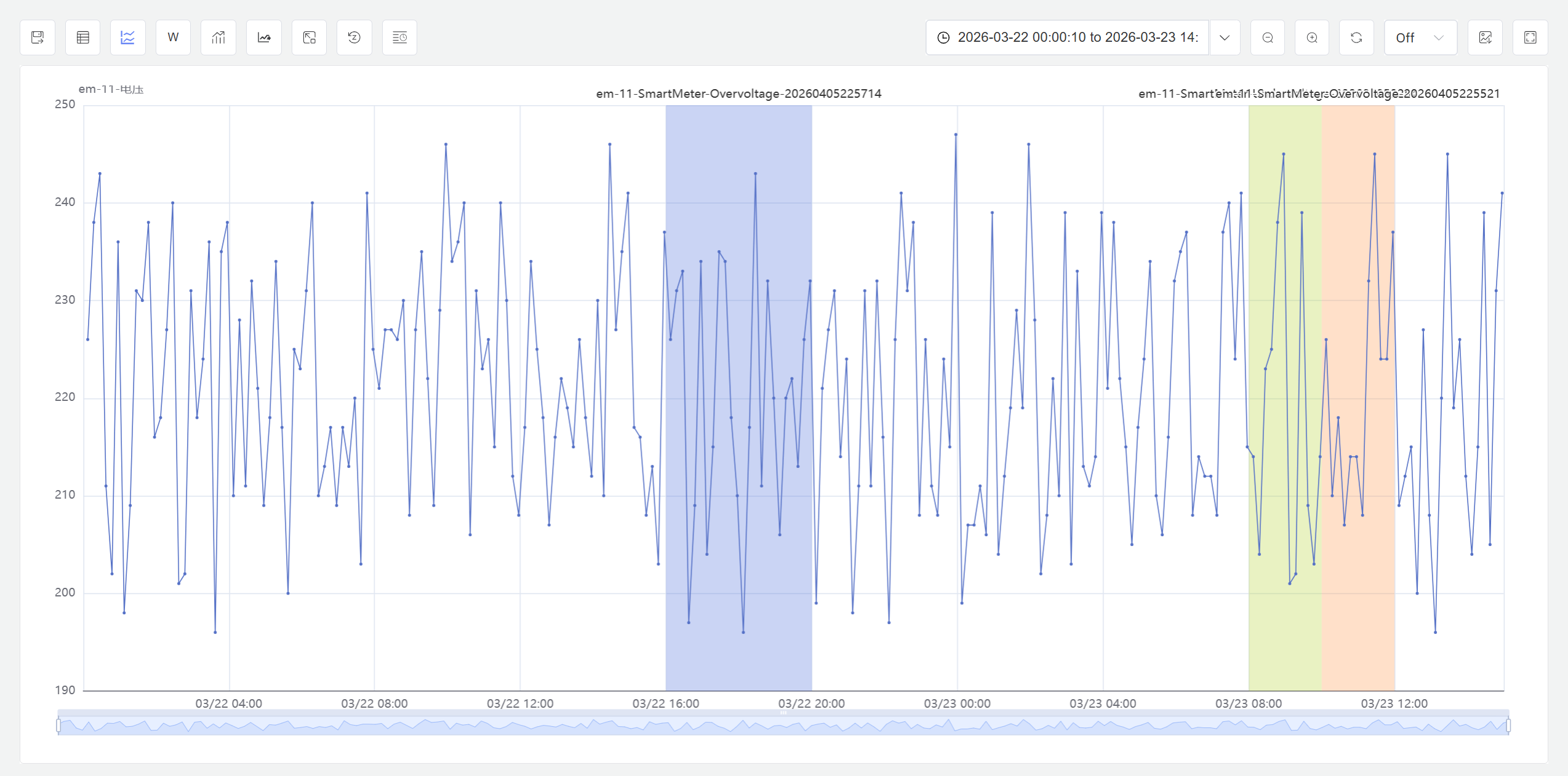

Trend Overlay Comparison​
In the Analysis Chart, overlay event time ranges onto process parameter curves to visually present how each parameter evolved during the event. After selecting multiple events, overlay their curves in the same chart for comparison, quickly identifying process differences, parameter drift, and anomalous fluctuations between events.
Multi-event curve overlay comparison
The figure above shows multi-event curve overlay comparison. By plotting complete process curves from different events on the same timeline, you can clearly see parameter performance during each event and identify events that deviate from the normal range.

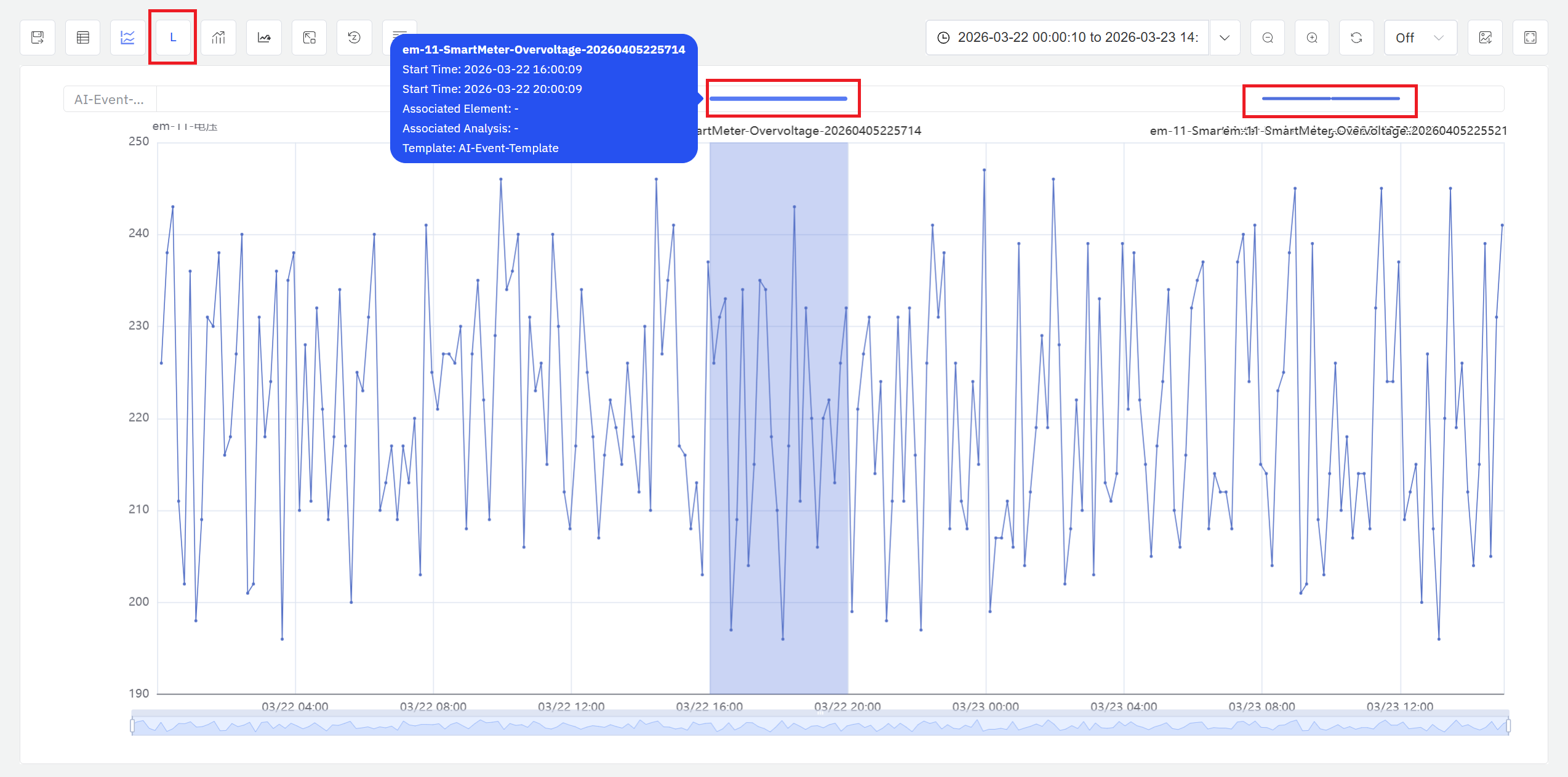

Event Line Display Mode​
When a large number of events are loaded into the Analysis Chart, the default overlay style — which renders events as shaded regions behind the trend curves — can make the chart difficult to read. In this situation, click Enable Event Line Mode in the toolbar. Events then appear as colored lines above the attribute trend chart; hovering over a line reveals the key details of the corresponding event. This display mode keeps the chart legible at high event density and makes it easier to spot distribution patterns across events.
Event line display mode

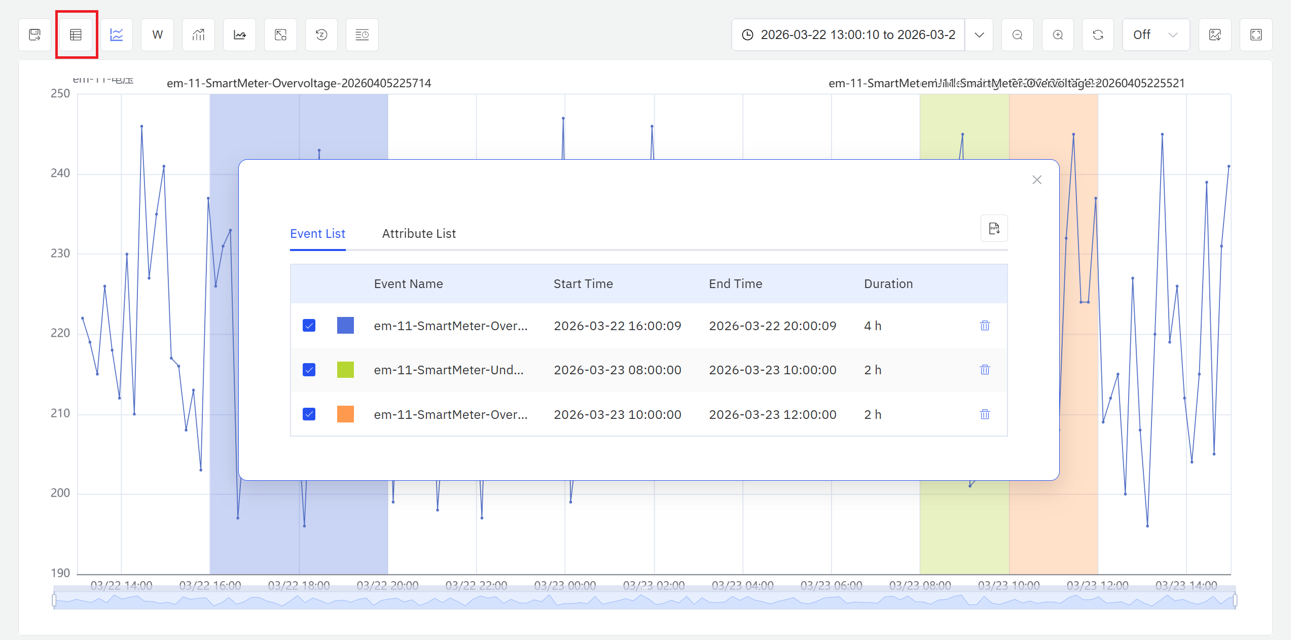

Event and Attribute List​
Click the Event and Attribute List icon in the Analysis Chart toolbar to open a summary window that presents the event list, the attribute list, and key statistics for the current analysis scope — such as event count, duration statistics, and attribute means or extrema. This gives users a quick operational overview before moving into detailed analysis.
Event and attribute list

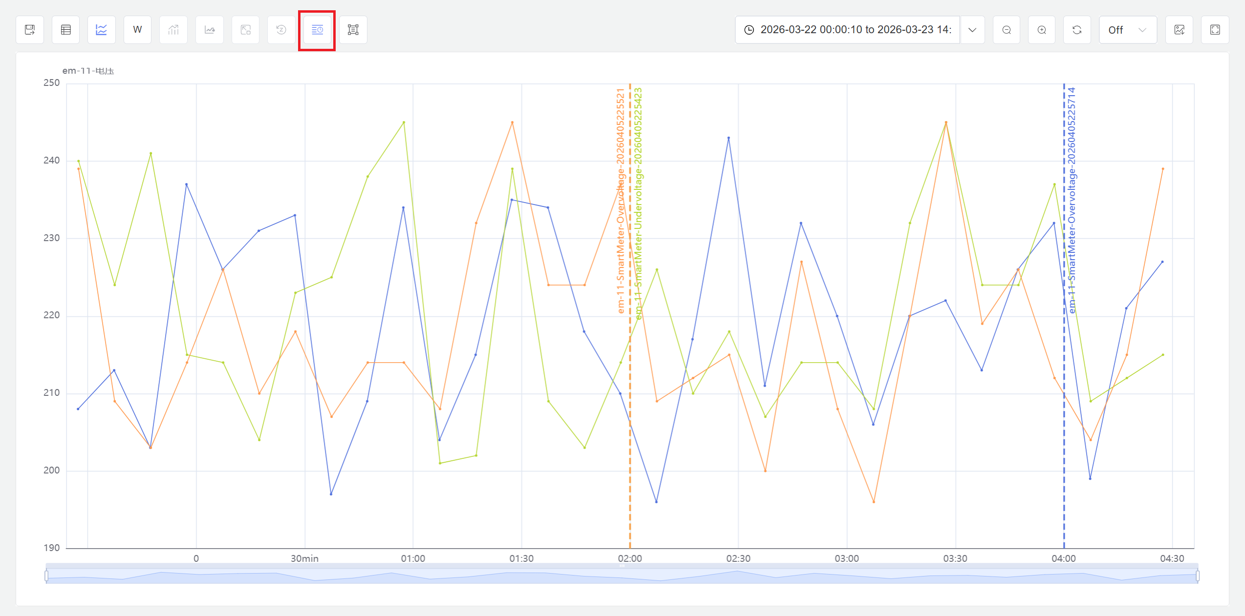

Time Alignment​
Time alignment aligns the start points of multiple events to the same moment (such as t=0), enabling direct comparison of process parameters at the same relative time points across different events. This eliminates the effect of actual event occurrence time differences, focusing on the internal process itself. Time alignment is particularly suited for analyzing parameter performance during relative time periods such as "first 2 hours from start" or "mid-reaction phase."
Time alignment analysis
As shown, all event start points are aligned to t=0, with the horizontal axis representing relative time since event start. This enables clear comparison of parameter performance at the same relative time points across events, identifying process execution consistency.

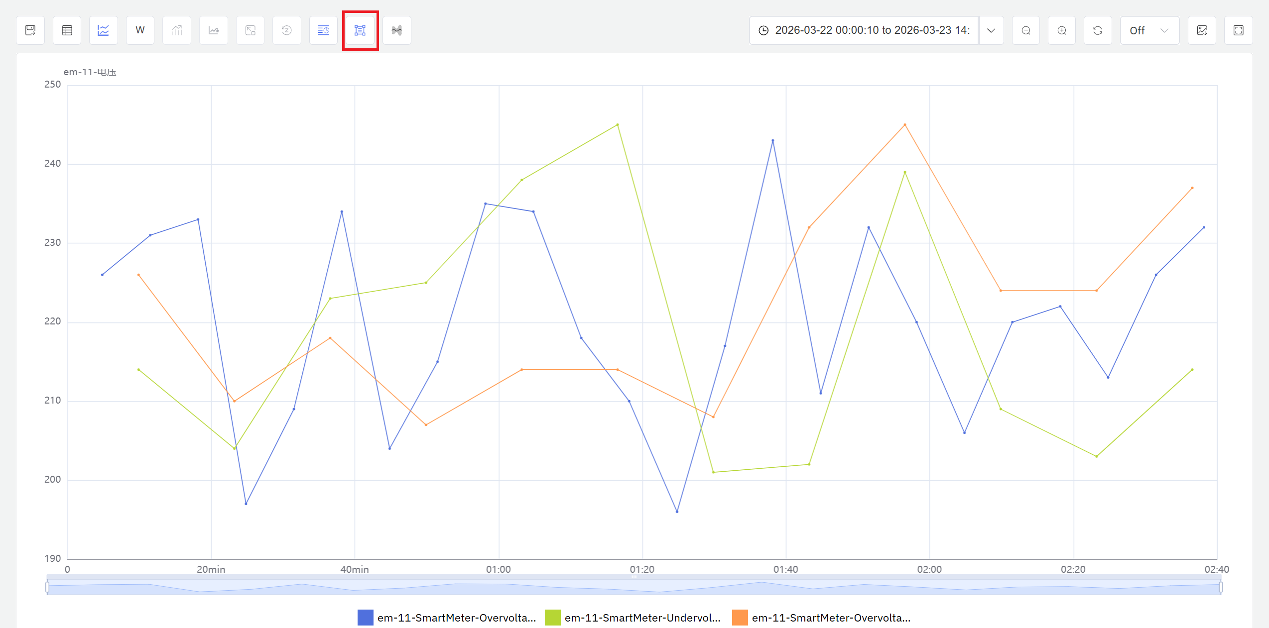

Time Normalization​
Time normalization maps events of different durations to a unified time scale (such as 0% to 100%), enabling comparison of events with varying lengths in the same coordinate system. After normalization, the horizontal axis no longer represents absolute or relative time, but rather event completion percentage. This method is particularly suitable for comparing events with significantly different cycle times (such as 6-hour vs. 8-hour batches), focusing on relative performance at each process stage rather than absolute duration.
Time normalization analysis
In this view, all event timelines are compressed or stretched to a unified 0%–100% scale, with the horizontal axis representing event completion progress. Through normalization, you can compare process parameters at relative progress points such as "first 25%," "mid 50%," or "final stage" across events of different durations, revealing differences in process execution rhythm.

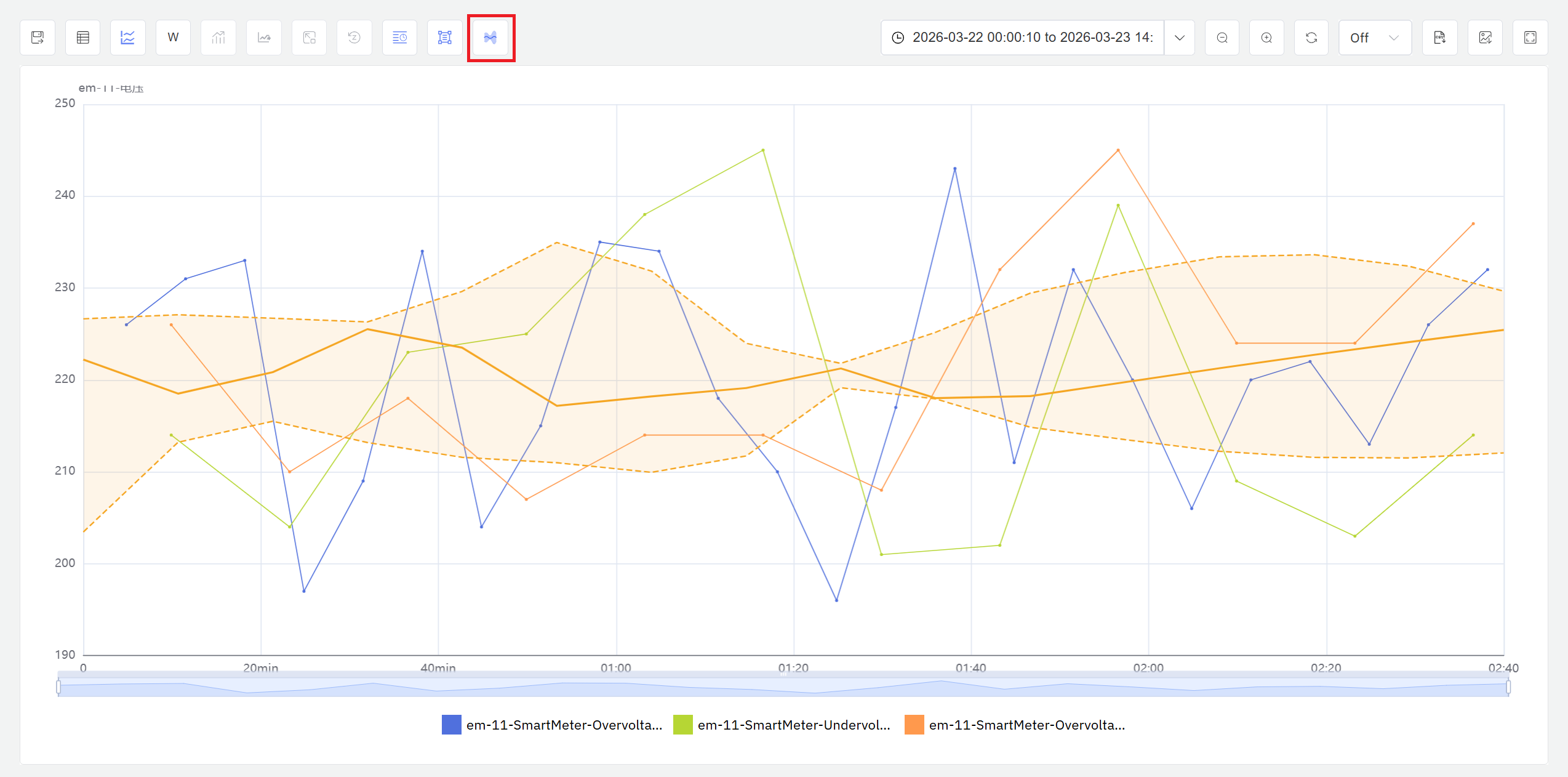

Envelope Analysis​
The envelope function automatically calculates and plots parameter boundary curves (such as maximum, minimum, mean ± standard deviation) based on historical event data. The envelope defines the normal parameter fluctuation range for events, forming a "safe corridor." Comparing a new event's curve against the envelope quickly reveals whether the event operated within normal bounds or deviated from historical patterns during specific time periods.
Envelope analysis
The orange area represents the normal parameter fluctuation range derived from historical reference batches (such as mean ± 2 standard deviations), while the colored curves show the actual parameter trends of the events being evaluated. When curves exceed the envelope boundaries, it indicates anomalous parameters during that period, requiring further investigation. The envelope provides a quantitative reference baseline for batch quality assessment.
