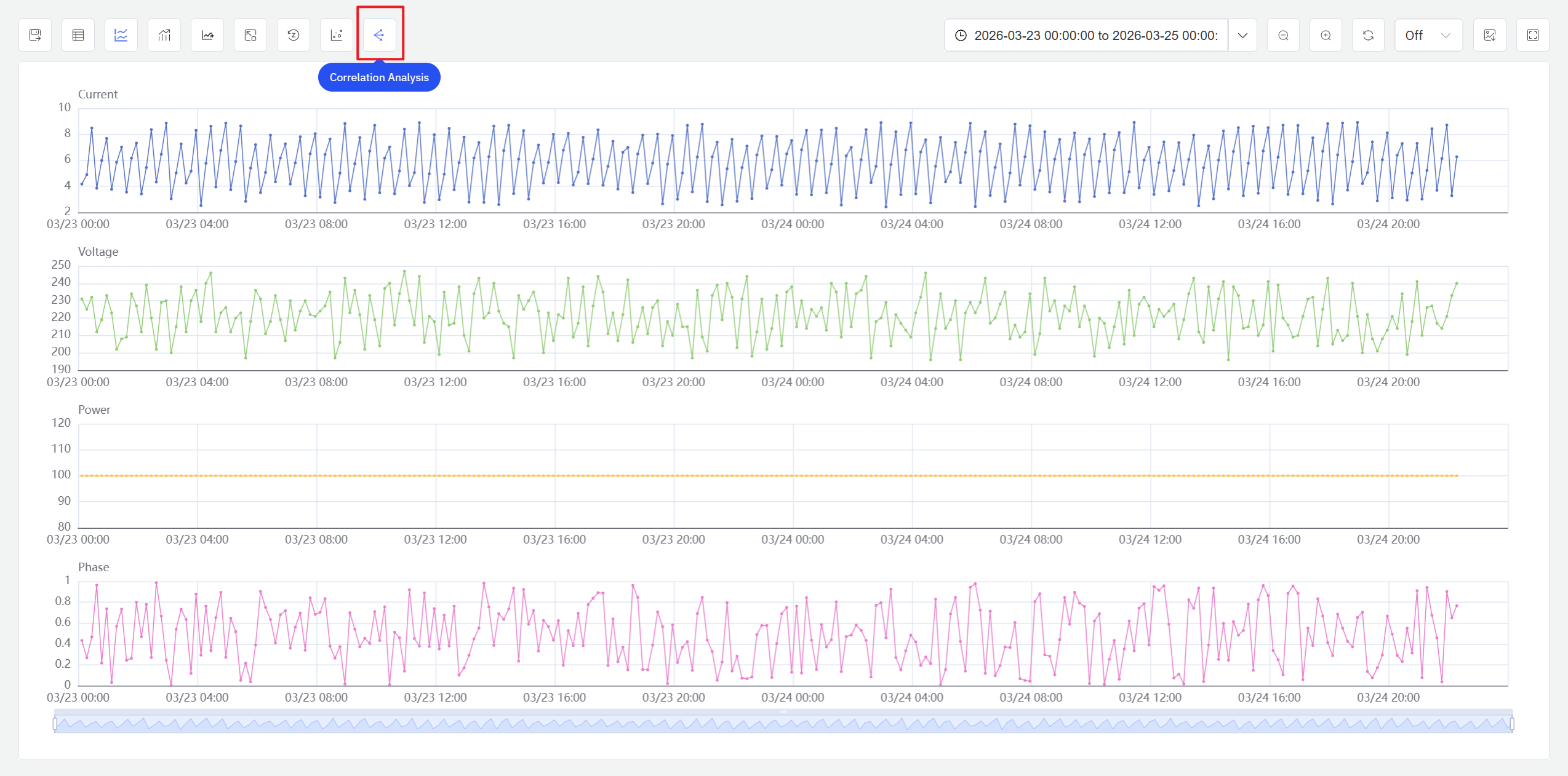

In an Analysis Chart panel in view mode, click the Correlation Analysis icon in the toolbar to access the correlation analysis feature. Only time-series attributes that have already been added to the Analysis Chart can participate in the analysis.
Steps:
  1. Open or create an Analysis Chart panel and add the time-series attributes you want to analyze (at least two).
  2. In the panel's view mode, click the Correlation Analysis icon in the toolbar. The system displays the correlation analysis configuration dialog.
  3. In the configuration dialog, select the attributes to analyze, configure the analysis parameters (described below), and click the Calculate button.
  4. The system performs pairwise correlation analysis on the selected attributes, and the results are displayed in the Result in Graph tab.
Correlation analysis entry page

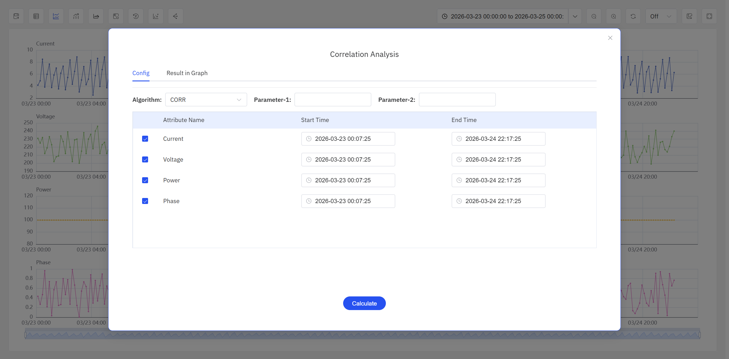

The configuration dialog contains the following settings:
ParameterDescription
Correlation AlgorithmSelect one of the three algorithms: CORR, DTW, or TLCC
Algorithm ParametersCORR requires no additional parameters; DTW allows configuring the neighborhood radius (Radius), default 1; TLCC allows configuring the lag window start/end steps (Lag Start / Lag End), default 0
Attribute ListDisplays all attributes currently added to the Analysis Chart; users can select which attributes to include in the analysis
Time RangeStart time and end time; defaults to the current chart's time range, adjustable by the user
Correlation analysis configuration page

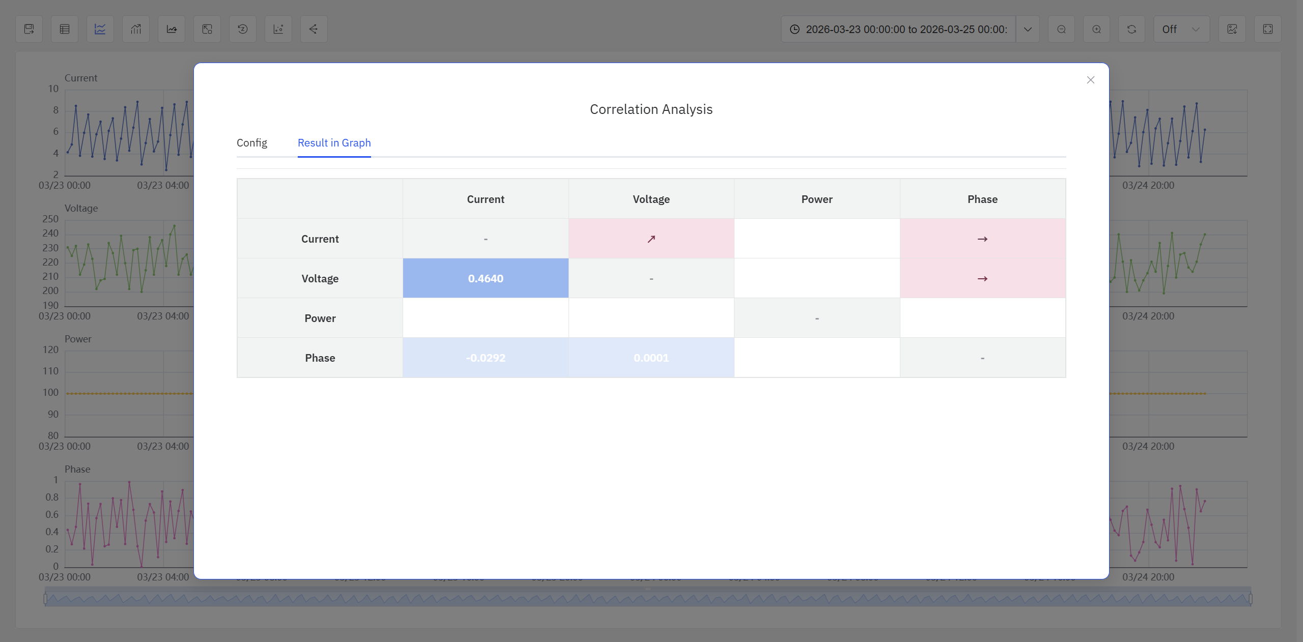

After the calculation completes, IDMP displays the correlation analysis results for all attribute pairs as a matrix heatmap in the Result in Graph tab:
  • Blue areas show the correlation coefficient values; stronger correlations appear in deeper shades
  • Pink areas show the sign (direction) of the correlation coefficient, with arrow direction indicating positive or negative correlation
Correlation analysis result page
note
If a correlation analysis has already been performed, clicking the Correlation Analysis icon again displays the previous results. Users can switch to the configuration tab to adjust parameters and recalculate.
