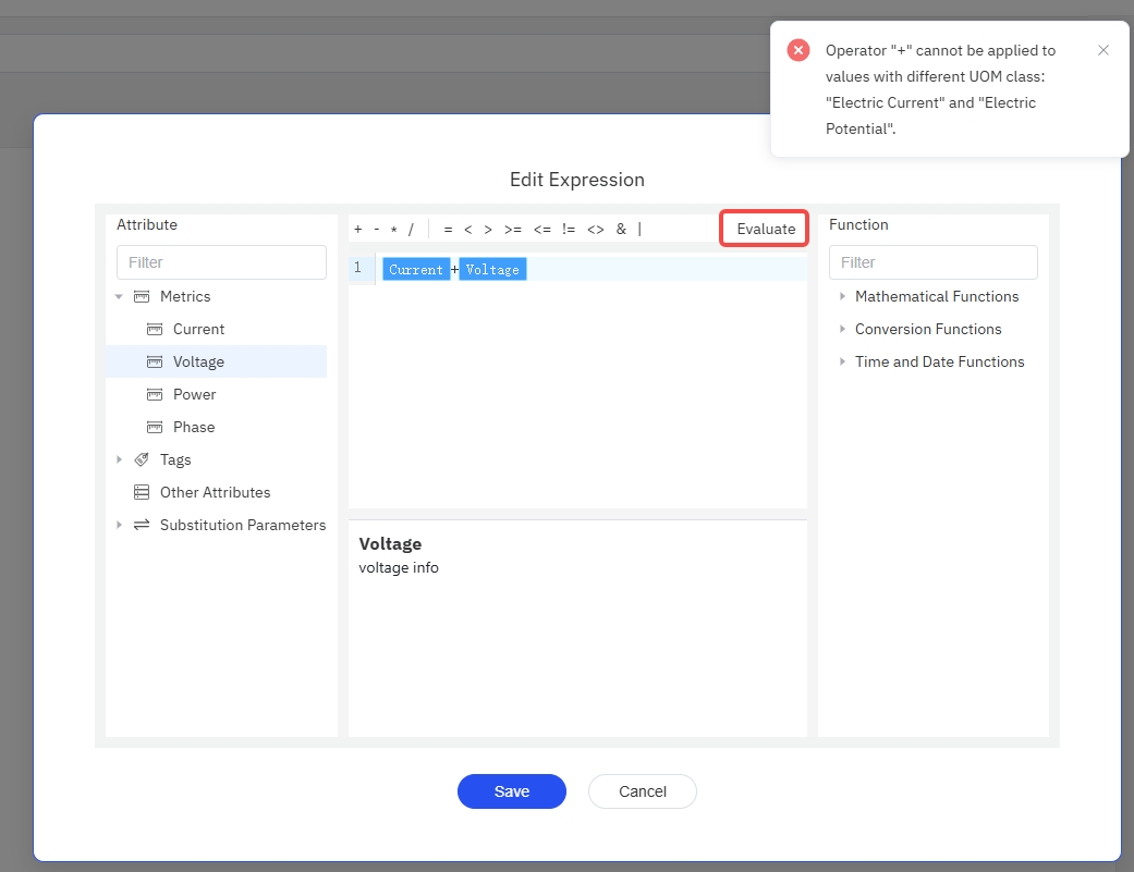

  1. If A and B belong to different unit of measurement classes (UOM Class), an error will be reported.

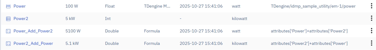

  2. If the two quantities belong to the same unit of measurement class but have different units (e.g., one is in watts (W) and the other is in kilowatts (kW)), the second quantity's unit will be converted to match the first quantity's unit.

For instance, attempting to add two attributes, electric current and electric potential, will result in an error: Operator "+" cannot be applied to values with different UOM class: "Electric Current" and "Electric Potential".
Another example: consider two attributes Power and Power2, with units W and kW respectively. The formula Power + Power2 yields a result in W, while the formula Power2 + Power yields a result in kW.
power add power2

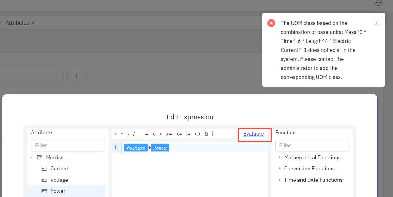

  3. If the unit of measurement class of the multiplication or division result is not defined in the system, an error will be displayed when editing the formula.

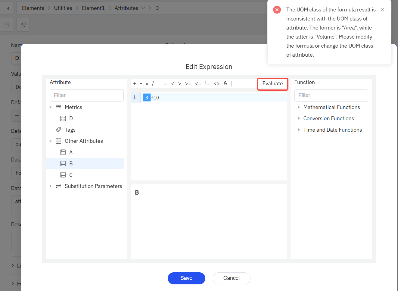

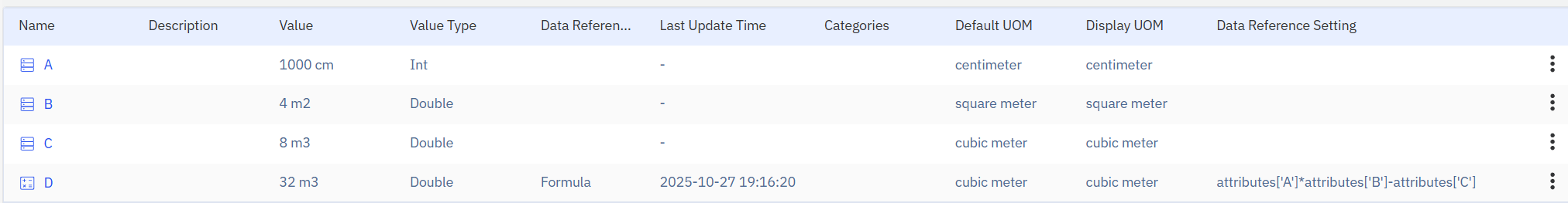

For example, suppose attribute A has unit centimeters (cm), attribute B has unit square meters (m2), and attribute C has unit cubic meters (m3). These involve 3 unit of measurement classes: length, area, and volume. For the formula A*B-C, A will first be converted to a value in meters, then multiplied by B to get a result in cubic meters, and finally subtracted from C. As shown below: formula A * B -C
Another example: multiplying electric potential by power results in a meaningless unit that doesn't exist in the system, which will trigger an error.

  2. When the unit of measurement of a formula result differs from the attribute's unit of measurement, the formula result is automatically converted to match the attribute's display unit of measurement.
If the unit of measurement of the formula result does not belong to the same unit of measurement class as the attribute's unit, automatic conversion is not possible.
