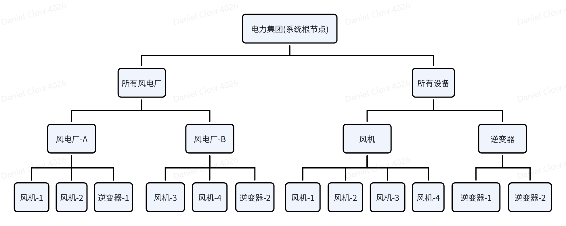

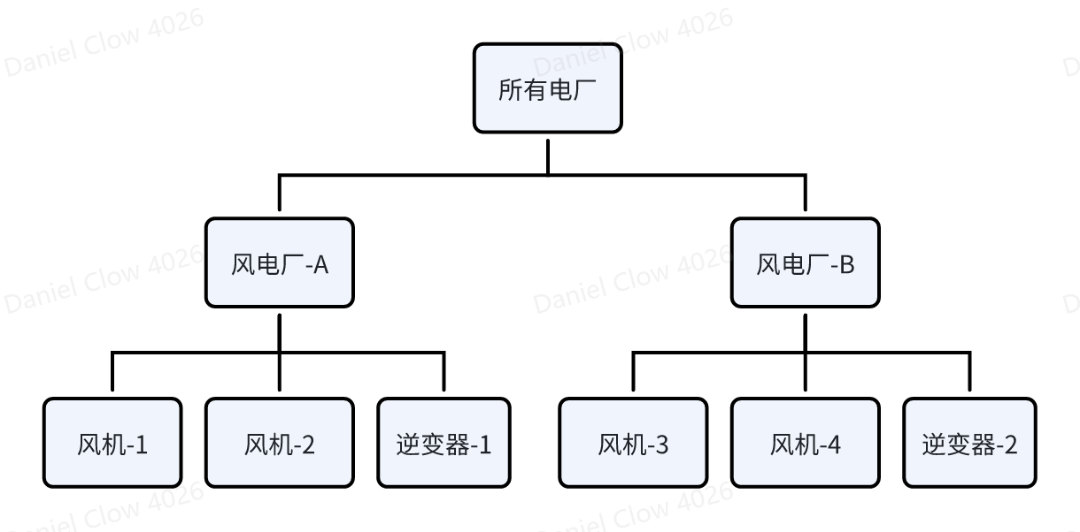

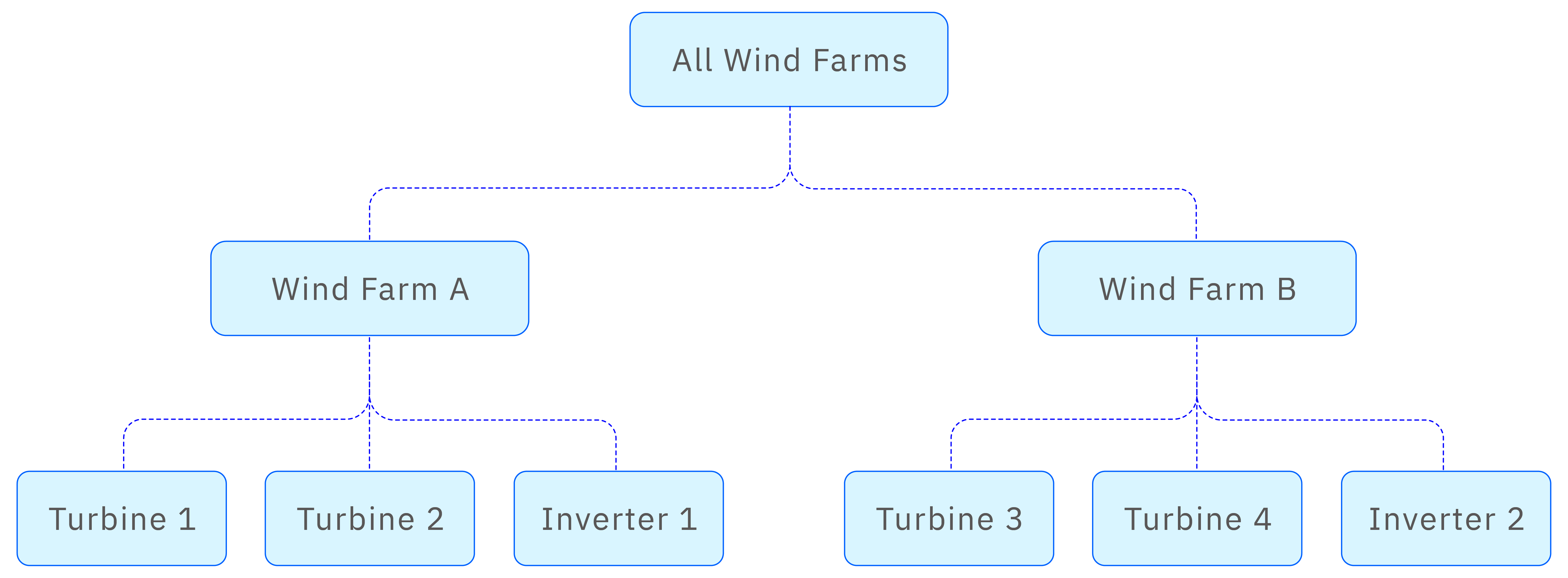

The modeling process involves continuously creating elements and building out the data catalog into a structure that reflects your real-world scenario. Imagine you work at a power company that operates multiple wind farms, each of which contains wind turbines and inverters. You could take a top-down modeling approach, starting by creating an element called All Wind Farms, and under that, creating elements for each wind farm, such as Wind Farm A, Wind Farm B, and so on. Under each wind farm, you could then add multiple wind turbines and inverters. In this way, the data model is built level by level, as illustrated in the following figure:
data-model-01

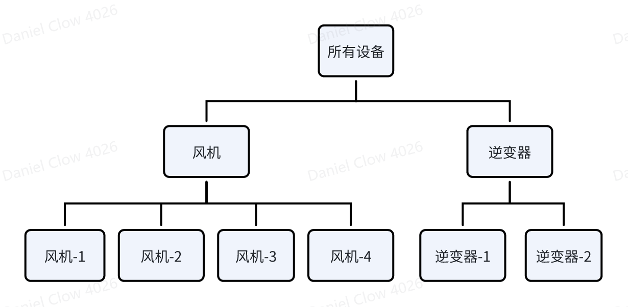

Enterprise asset management often involves multiple organizational models, and different roles may require different data perspectives. For example, operations personnel may prefer to organize the tree structure by site or plant, as shown above, while equipment maintenance teams may prefer to organize it by equipment type, like the following figure:

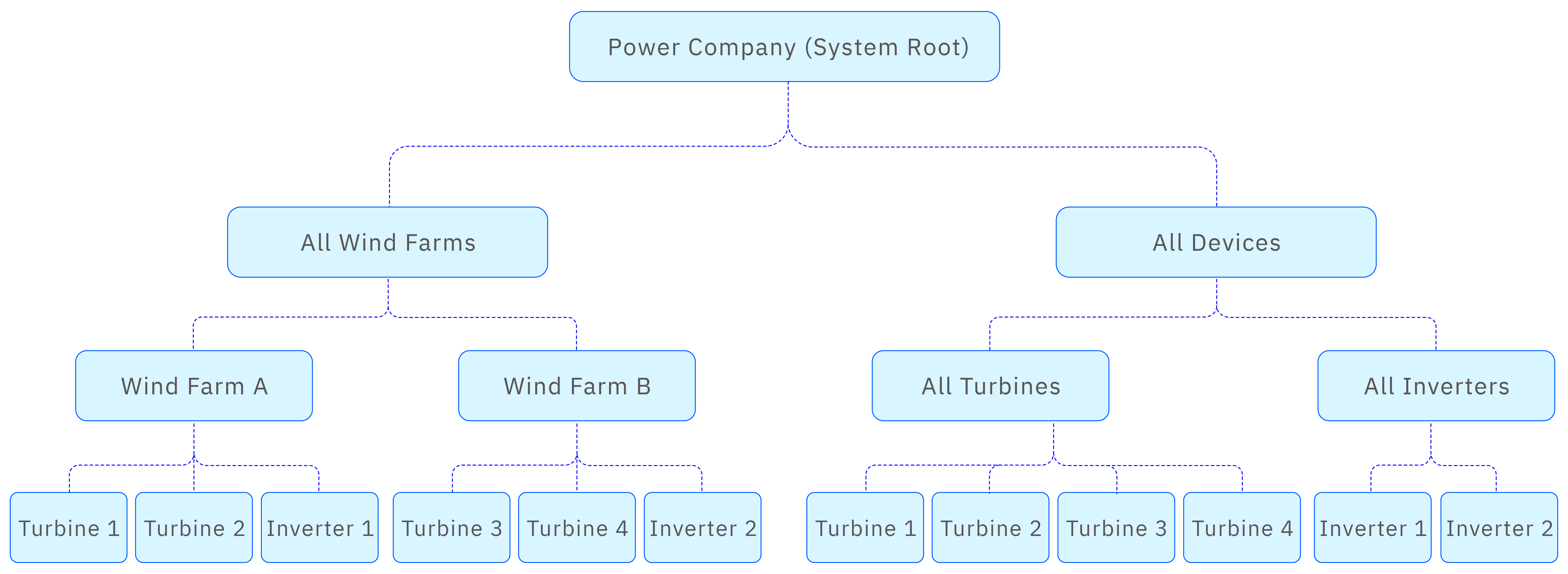

In TDengine IDMP, an element can belong to multiple hierarchies through element referencing, making it easier to manage from different perspectives. In the case of wind power, you could construct a tree containing both perspectives:
data-model-03 Although elements such as turbines are repeated in the tree, element references are used to reduce duplicate data and ensure consistency. For more information, see Element References.

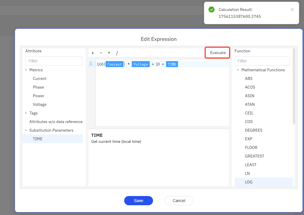

A formula reference is set using an expression. It is ultimately converted into a TDengine SQL expression and executed by TDengine TSDB. A formula reference expression is a combination of attributes, operators, replacement parameters, constants, and functions. The attributes it references must be of a numerical type, and its output must also be numerical. For example:
log(current) * voltage +10 + TIME
The image below shows a configuration example for a formula reference expression:
Formula Expression Configuration
note
  1. Currently, the only available replacement parameter for formula reference expressions is TIME, which will be replaced by the number of milliseconds corresponding to the current local time.
  2. Currently, the attributes referenced by a formula expression can only be those of the current element. To reference an attribute A from a non-local element, the recommended strategy is to add a new attribute A' to the current element, making A' reference the same external data as A.
info
On the expression editing interface, you can click "Evaluate" at any time to test the current expression. IDMP will perform a validity check on the expression. If the check passes, it will further attempt to compute it. If a computation exception occurs, the corresponding SQL statement and SQL exception will be thrown. You can adjust the expression based on the exception information.

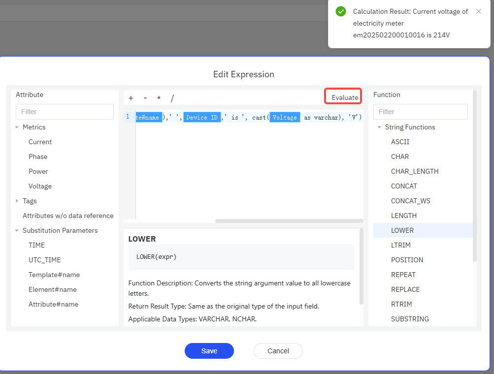

You cannot use the plus sign (+) to concatenate strings. To concatenate strings, please use the CONCAT function on the right side of the formula editor interface. Each parameter of the CONCAT function must also be of string type. To concatenate a numerical-type attribute into a string, please convert it first using the CAST function, for example: CONCAT(Address, '-', CAST(Voltage as varchar)).
The image below shows a configuration example for a string builder reference:
CONCAT('Current voltage of ',LOWER(${Template#name}),' ',${attributes['Device ID']},' is ', cast(${attributes['Voltage']} as varchar), 'V')
