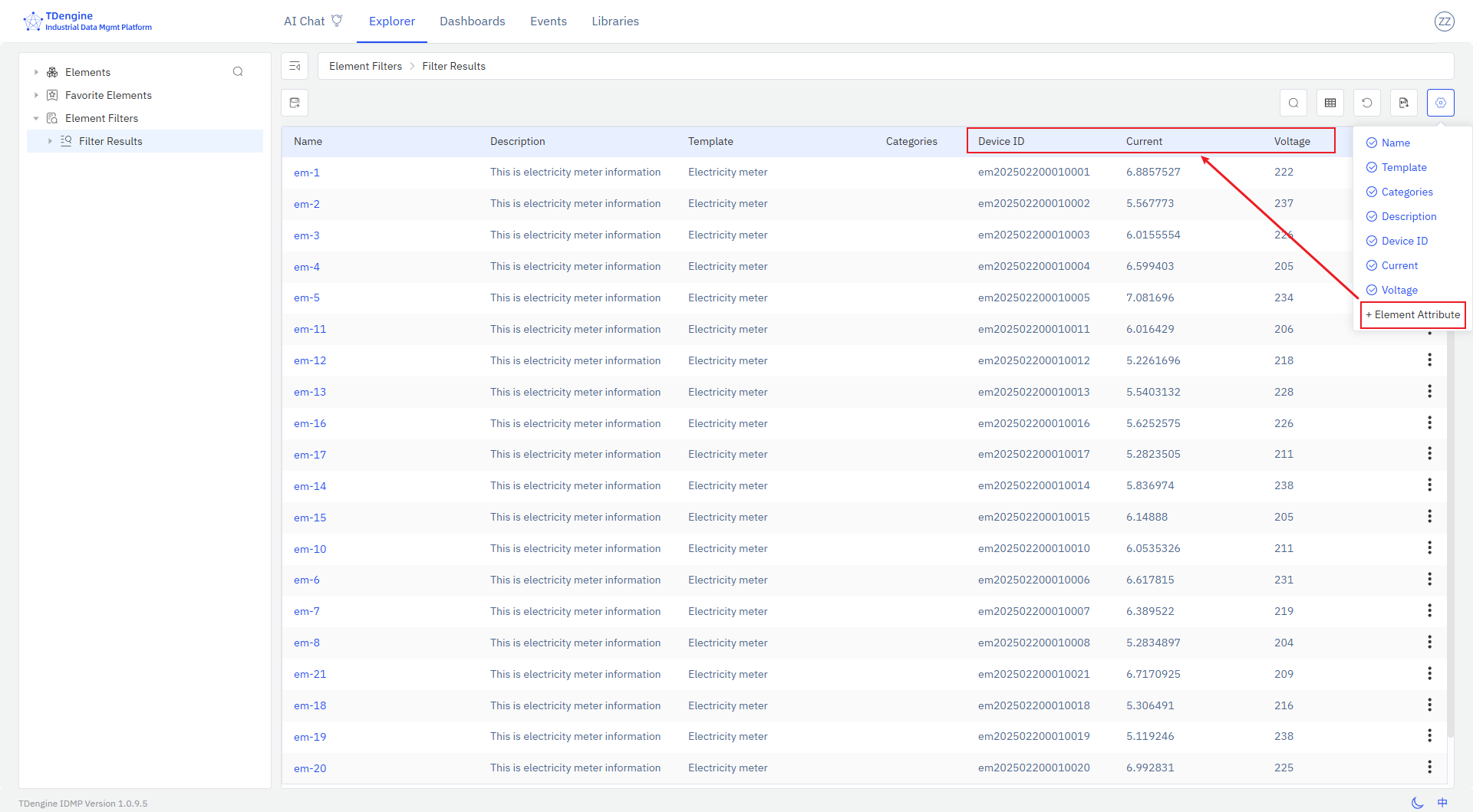

Saving Element Query Results as Asset Lists
If the retrieved elements come from the same element template, you can add element attributes to the list; you can also click on existing column names to remove unwanted columns.
Asset List Entry
After configuring the query conditions and selecting the columns to display, you can click the "Save as Asset List" button to save the current query results as an asset list panel.
Asset List Entry

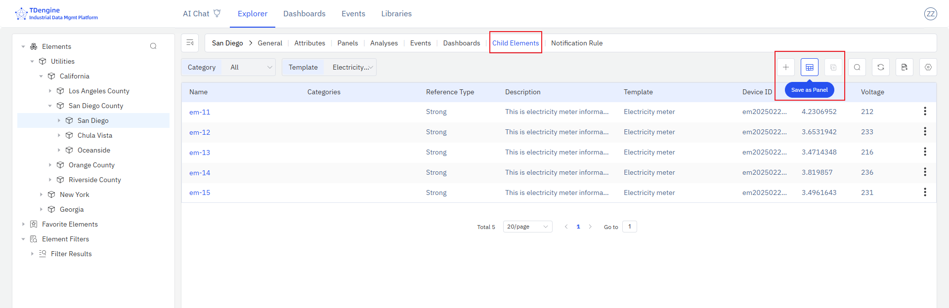

Saving Child Element Lists as Asset Lists
After selecting an element on the left, click the "Child Element List" icon in the action area to enter the child element list page. If all child elements come from the same element template, you can add element attributes to the list; you can also click on existing column names to remove unwanted columns.
After selecting the columns to display, you can click the "Save as Asset List" button to save the current child element list as an asset list panel for the current element. Switch to the "Panels" tab to see the newly saved asset list panel.

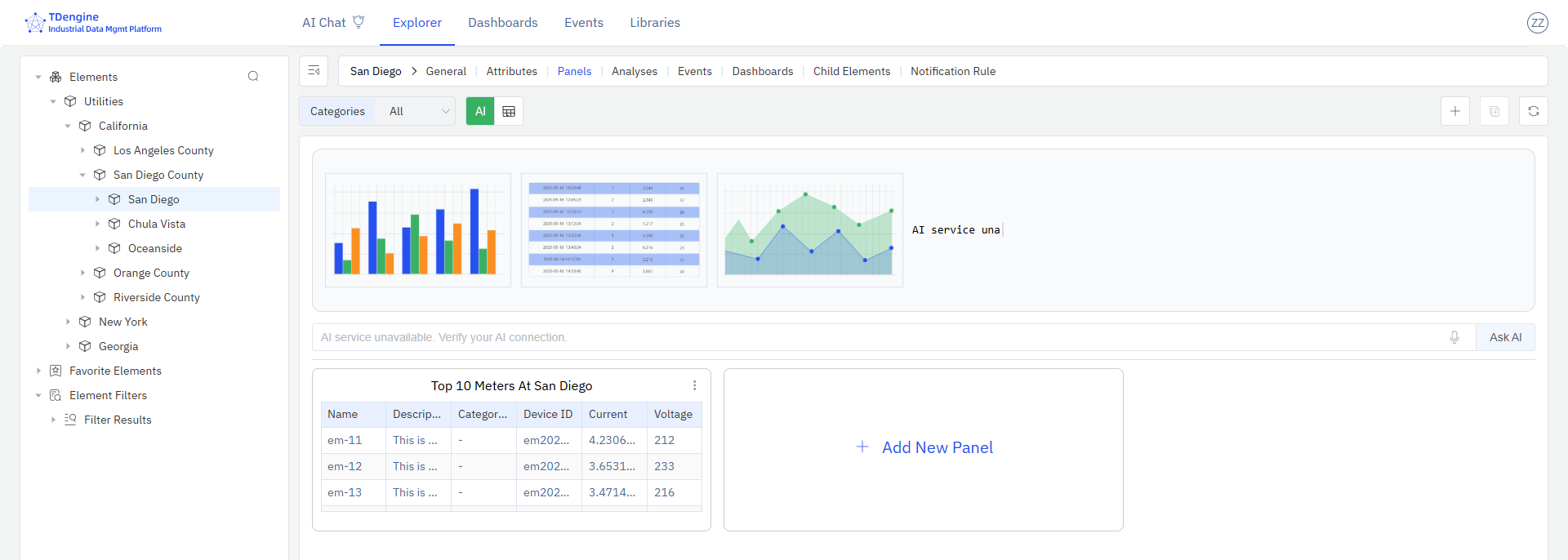

Asset List Panels
After successfully saving the asset list, you can see the display effect of the asset list in the panel, as shown in the figure:
Asset List Panel
