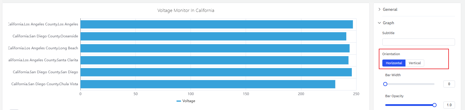

Orientation
The layout of a bar chart includes horizontal and vertical options, with the vertical layout as the default. When set to the horizontal layout, the display is as follows.

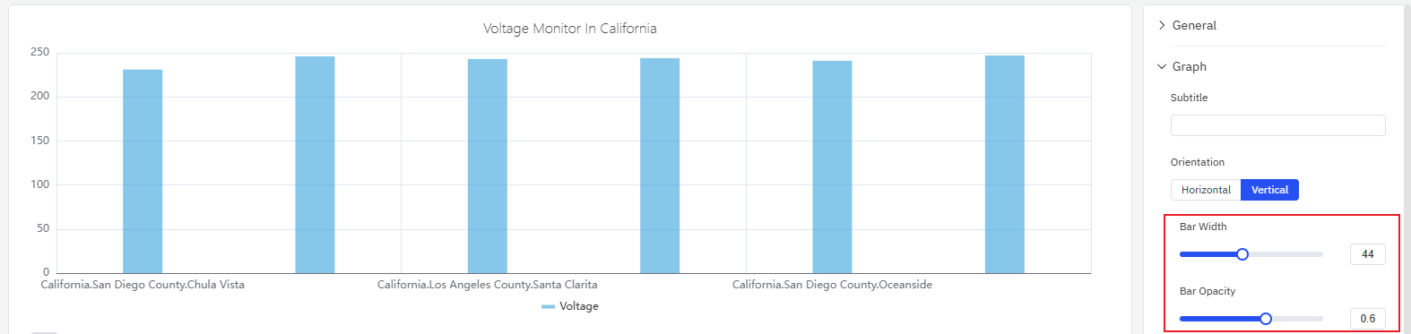

Bar Style
As shown in the figure below, you can adjust the width and transparency of the bars in the bar chart. If the bar width is not set, it will be automatically calculated based on the overall width of the current chart and the number of bars, providing good adaptability. Manual adjustment of this width is only recommended when displaying the chart on a fixed-width screen to achieve the optimal display effect; otherwise, it is not advised.

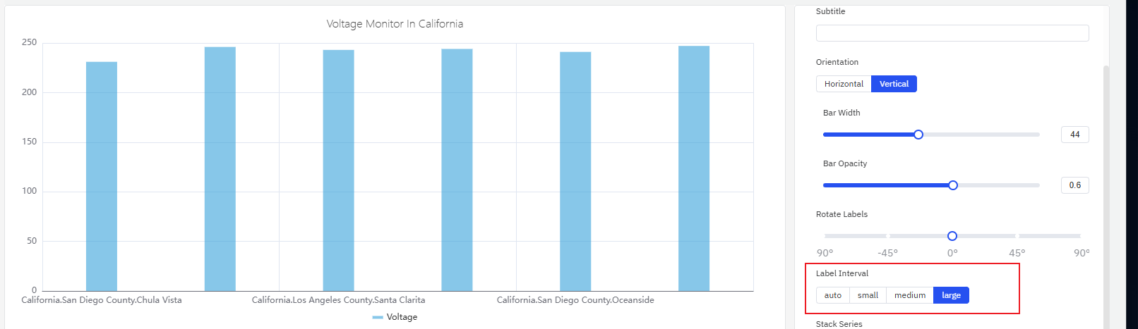

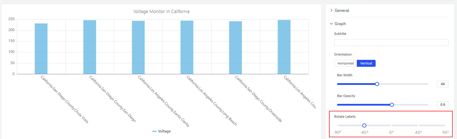

Labels
Configure the label rotation angle to avoid label overlap
Adjust the label interval to reduce label density avoid label overlap

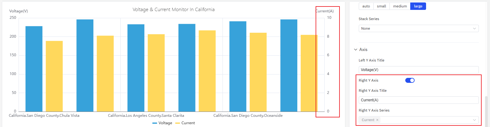

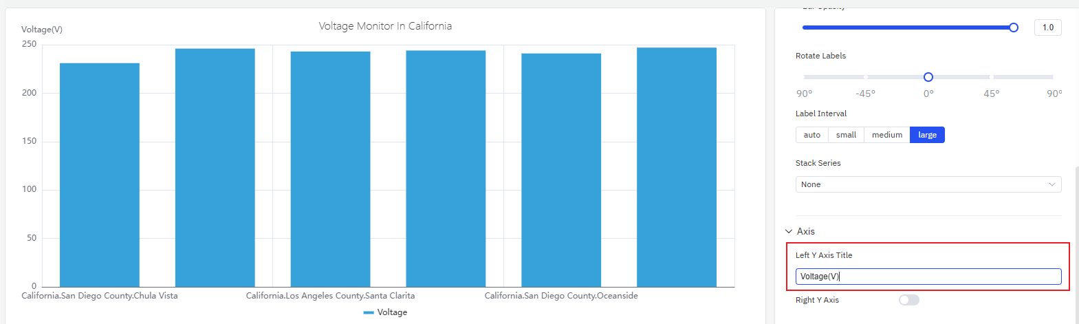

Axis
The coordinate axis can be configured to display the axis name and its unit of measurement.
When displaying two indicators in one chart, if there is an order-of-magnitude difference in their measurement ranges, the analysis of one of the indicators will be affected. In such cases, you can enable the right Y-axis and use the dual Y-axis mode to display the indicators.

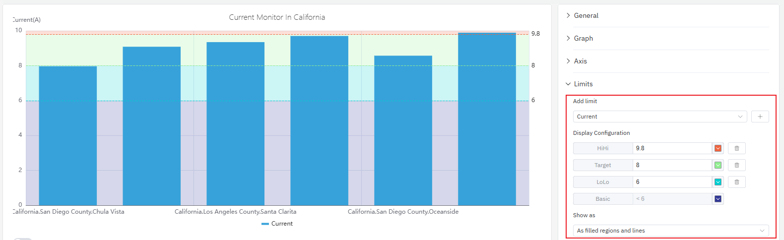

Limits
You can configure limits to identify the safe zone and warning zone of the indicator, which facilitates better analysis and observation.

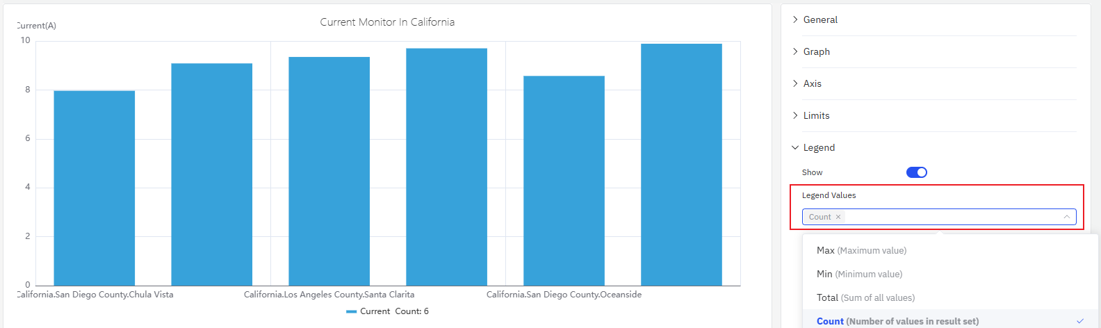

Legend
You can enable the display of statistical values such as maximum and minimum values in the legend.
