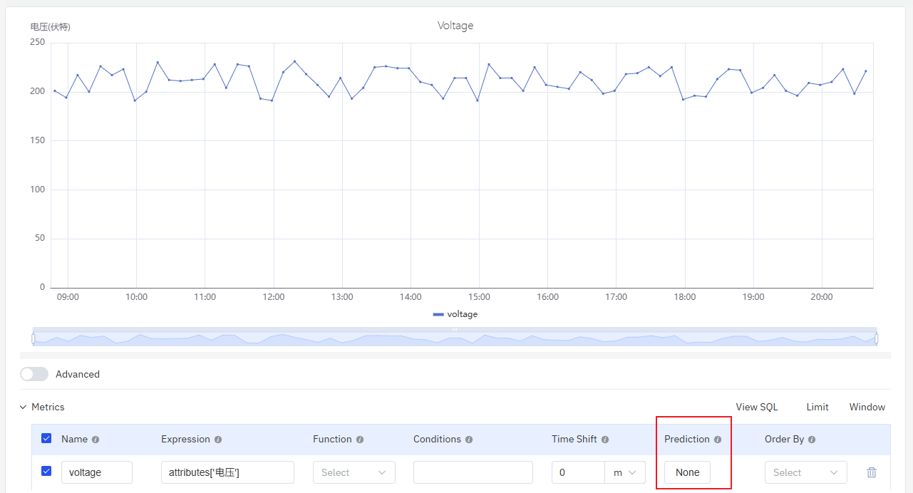

Enabling Forecasting
Each metric can have prediction enabled independently, as shown in the figure below. For indicators with prediction enabled, other configuration items need to remain at their default values; if complex expressions or functions are used, correct prediction cannot be performed.

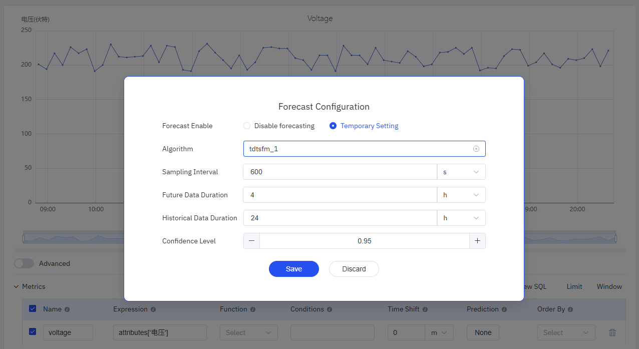

As shown in the figure below, after clicking the button in the Prediction column, an algorithm configuration form will pop up. For more detailed explanations, please refer to Time-Series Forecasting.
  1. Algorithm: Forecasting algorithm. Please select an available algorithm deployed on the anode.
  2. Sampling Interval: Sampling Interval of Predicted Data.
  3. Future Data Duration: It determines the number of records in the prediction results (future data duration / sampling interval).
  4. Historical Data Duration: It determines the number of sample records used by the algorithm.
  5. Confidence Level: Confidence interval range of predicted data, with the value range adjusted to (0, 1].
  6. Covariates: Optional. Allows you to select other metrics in the current panel to be used as covariates in the prediction calculation. Currently, this is only supported by the moirai prediction algorithm.

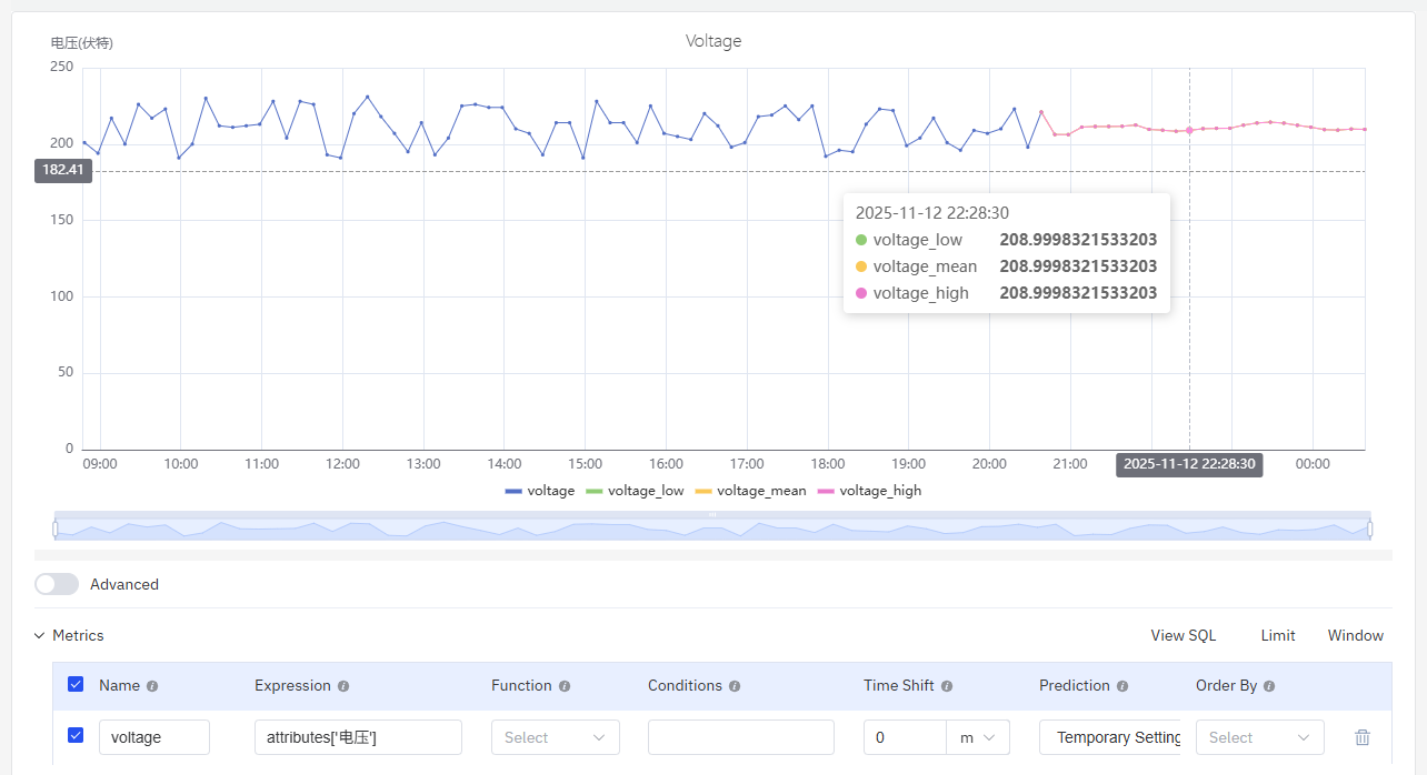

Forecasting Results
As shown in the figure, each sampling time point will have three values, corresponding to the upper bound (_low), mean (_mean), and lower bound (_high) of the confidence interval.

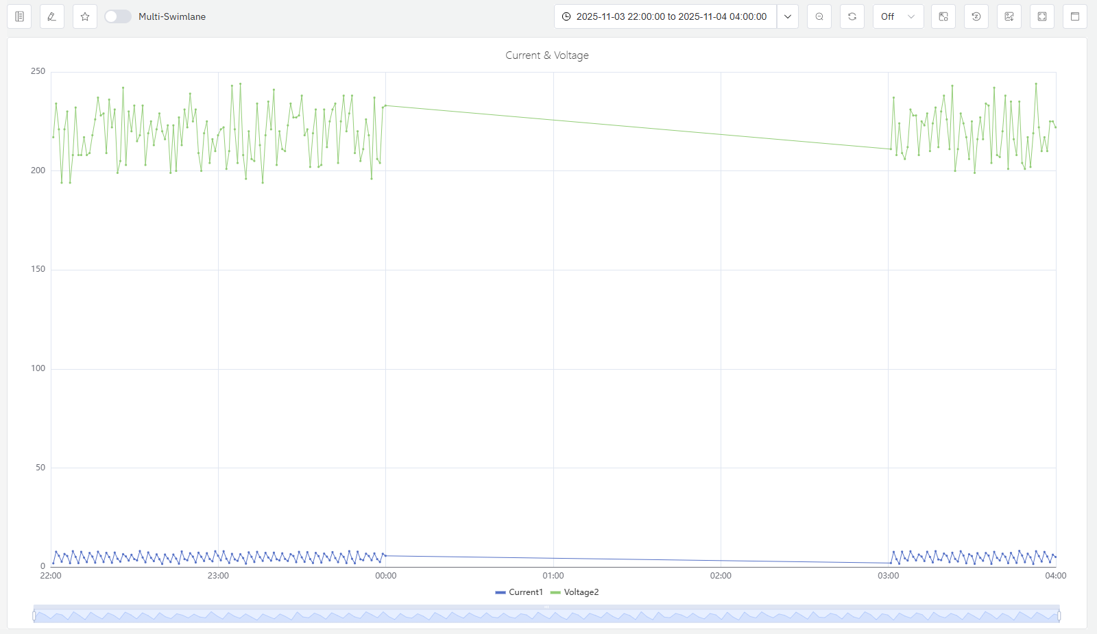

Data Missing Identification
As shown in the figure, if a curve like this appears in the trend chart, it indicates that there may be a certain data loss issue.

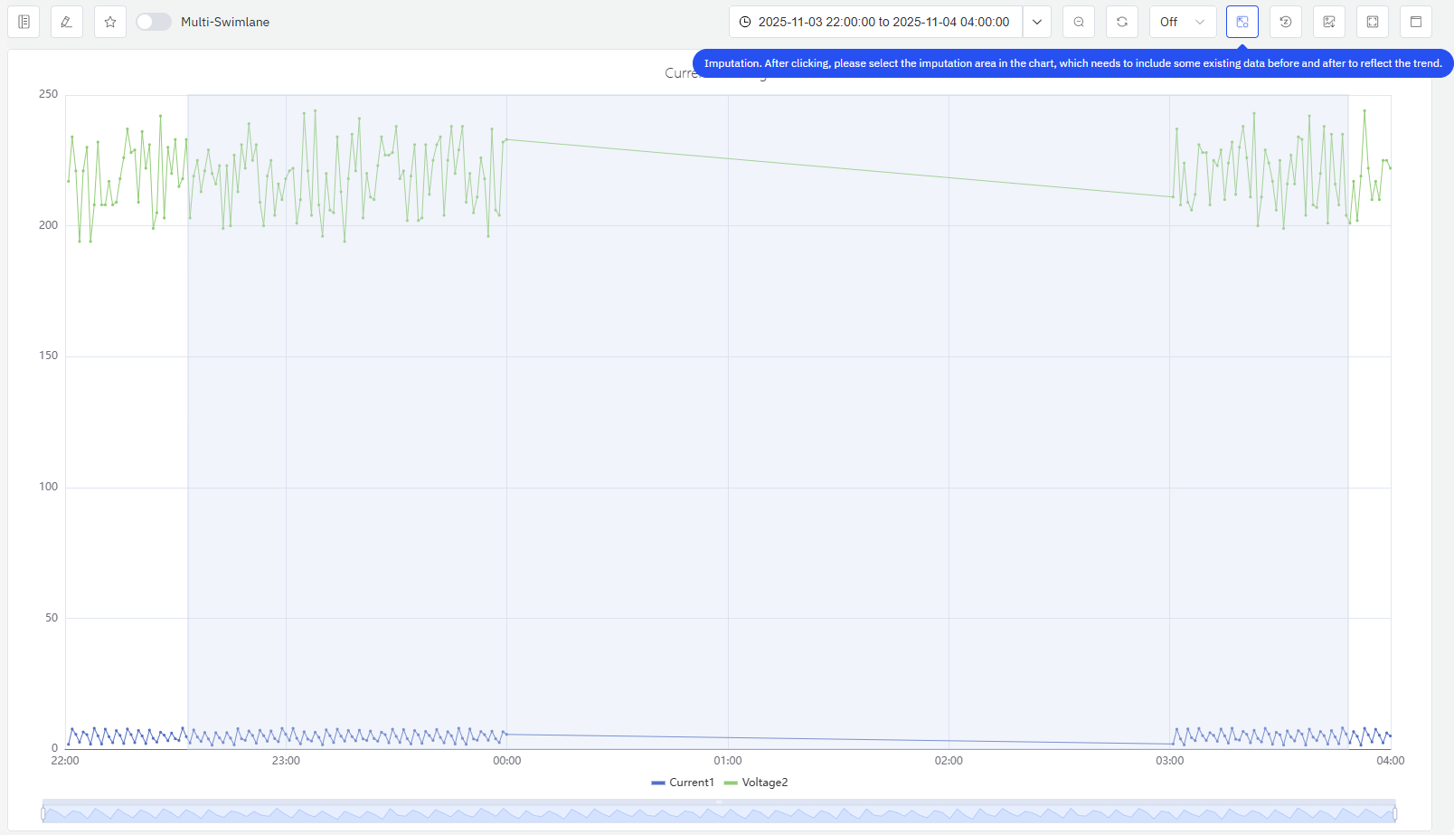

After clicking the Imputation button, you can press and hold the mouse on the trend chart to select the imputation area. The selected area must include a certain range of existing data before and after the missing part. This is to reflect the trend changes, enabling the imputation algorithm to fill in the missing data with more reliable basis.
imputation trigger

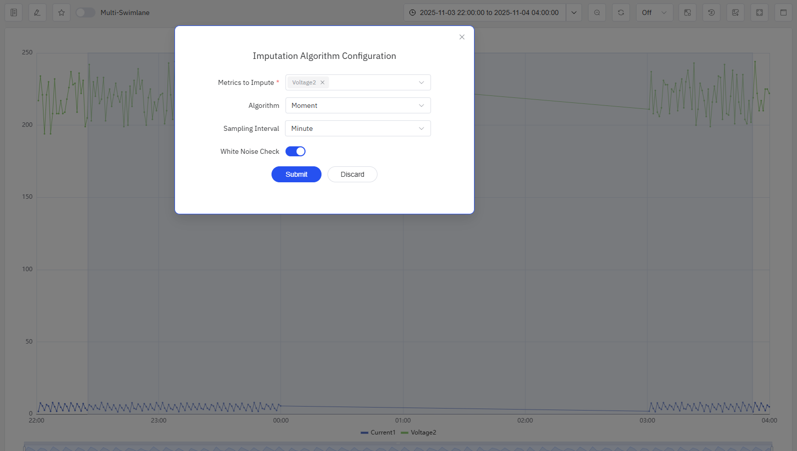

After selecting the imputation area, an imputation algorithm configuration form will pop up. Once filled out, the form can be submitted to obtain the imputed data. The imputation algorithm parameters include:
  1. Metrics to Impute: Select from the current metric; multiple selections are supported.
  2. Algorithm: Currently, only the Moment algorithm is supported.
  3. Sampling Interval: When the interval between two consecutive data sampling points is greater than 2 sampling intervals, data loss is considered to have occurred, and data imputation will be performed.
  4. White Noise Check: After enabling this function, a white noise check will be performed. If the number of selected existing data points is too small and the algorithm fails to fit valid patterns, the data will be regarded as random values, and an error will be reported directly.
